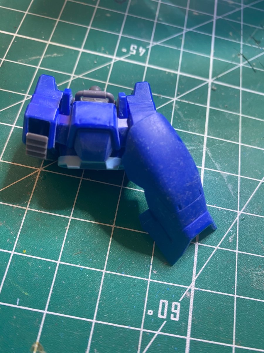

once again I used the glass file to get the nub marks off.
that piece on the leg was partially annoying. I don’t understand why they couldn’t just include it on one of the leg halves….
Not a bad kit! A few loose parts but perfectly suitable.

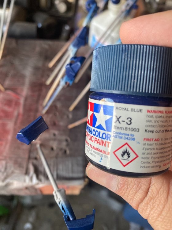

I tried using glue stick glue to attach the small parts onto the skewers rather than trying to figure something out with the clips. It actually worked really well! Was firm enough to paint with and easy enough to take off when done.
We primed everything first of course.
it may be called “royal blue” but it’ll always be Titan’s blue to me!

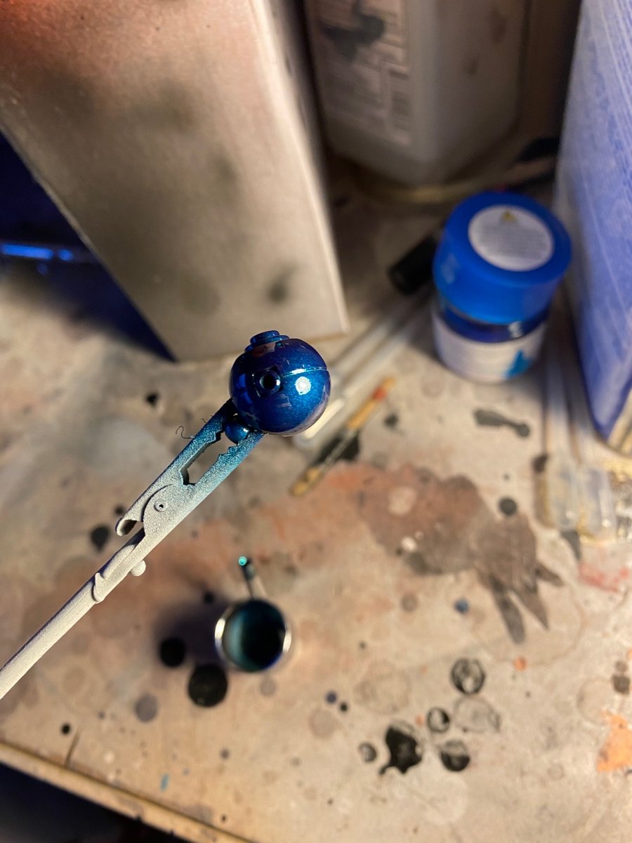

This was the tricky part… my normal blue was far too dark to use. I had to lighten it up. When all was said and done I ended up using 3 parts white, 1 part blue, 1 part red, and equal parts (if not more) thinner (alcohol).

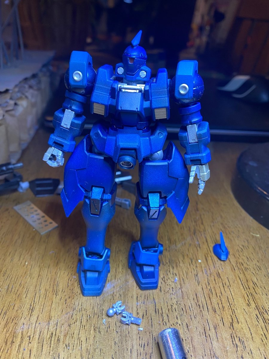

It’s not perfect but I think it’s a pretty handsome blue that came out. 893A26CD-38AA-491D-BCE3-8A83CA63CA8B.thumb.jpeg.7326eb0a9cdddf4bb5207271fa75dba0.jpeg
I don’t think it’s too far off the mark…
I think the OZ space forces would be proud!

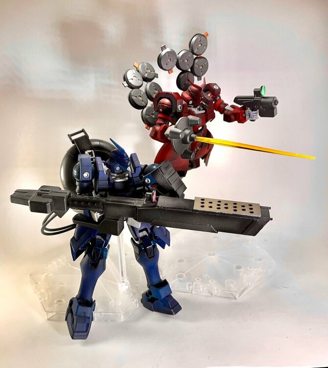

One of my biggest complaints about the design of the Vayeate was the simplicity of the beam cannon. So I asked myself with my build of the kit, “What role will this weapon have?” Two thoughts came to mind, one being that the beam cannon should act more like a sniper since the Mercurius would be close quarters. The only problem with this is that converting the existing kit to resembled something more rifle-ish would either be too long or too ambitious to try. The next conclusion i got to was that well maybe it doesn’t have to be that extreme end of the spectrum. If we look at the Mercurius it has a beam pistol on top of its crash shield. What if the Vayeate would act as more of an “enforcer” type role. Something to barge in closer and unleash utter detestation?
My conclusion is the “beam shotgun” basically I used Pla plate to make a casing to house the original beam cannon. It took some trial and error but I’m pretty happy with how it turned out. What do you guys think?

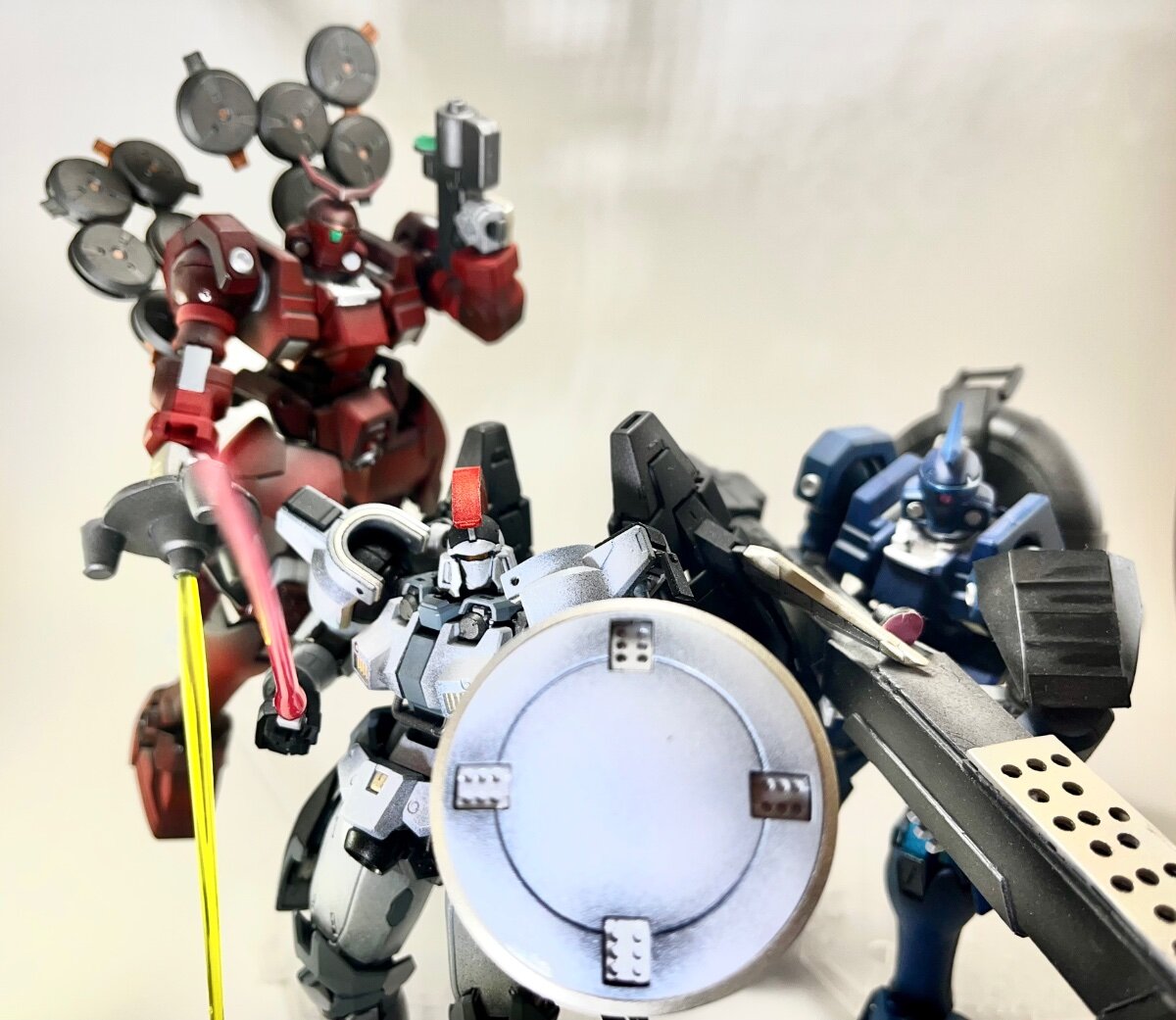

And so we have the twins relatively ready to go! I decided to add a sort of “blast shield” on the Vayeate’s shoulder, I feel like it added more to the “enforcer” type of role I was envisioning. I also added additional platting on the knee caps of both units. I decided to pain the inside thrusters on the leg armor as well to match the other thrusters too. I’ll try to get a photo shoot with these guys soon!
